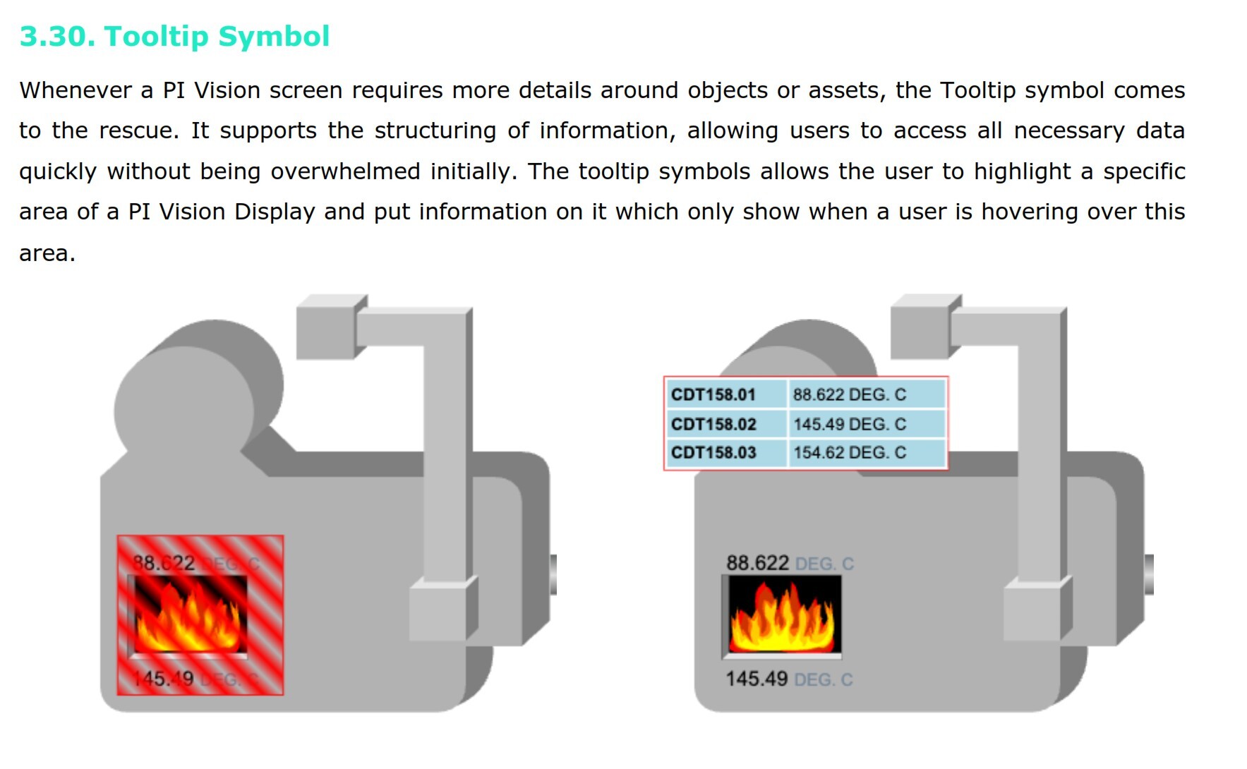

    Hey Vijay,
    Maybe the Custom Tooltip Symbol could be a solution for that. With this you can draw custom areas and put information from PI Tags behind to be displayed on hover. Find an example attached.
    Cheers
